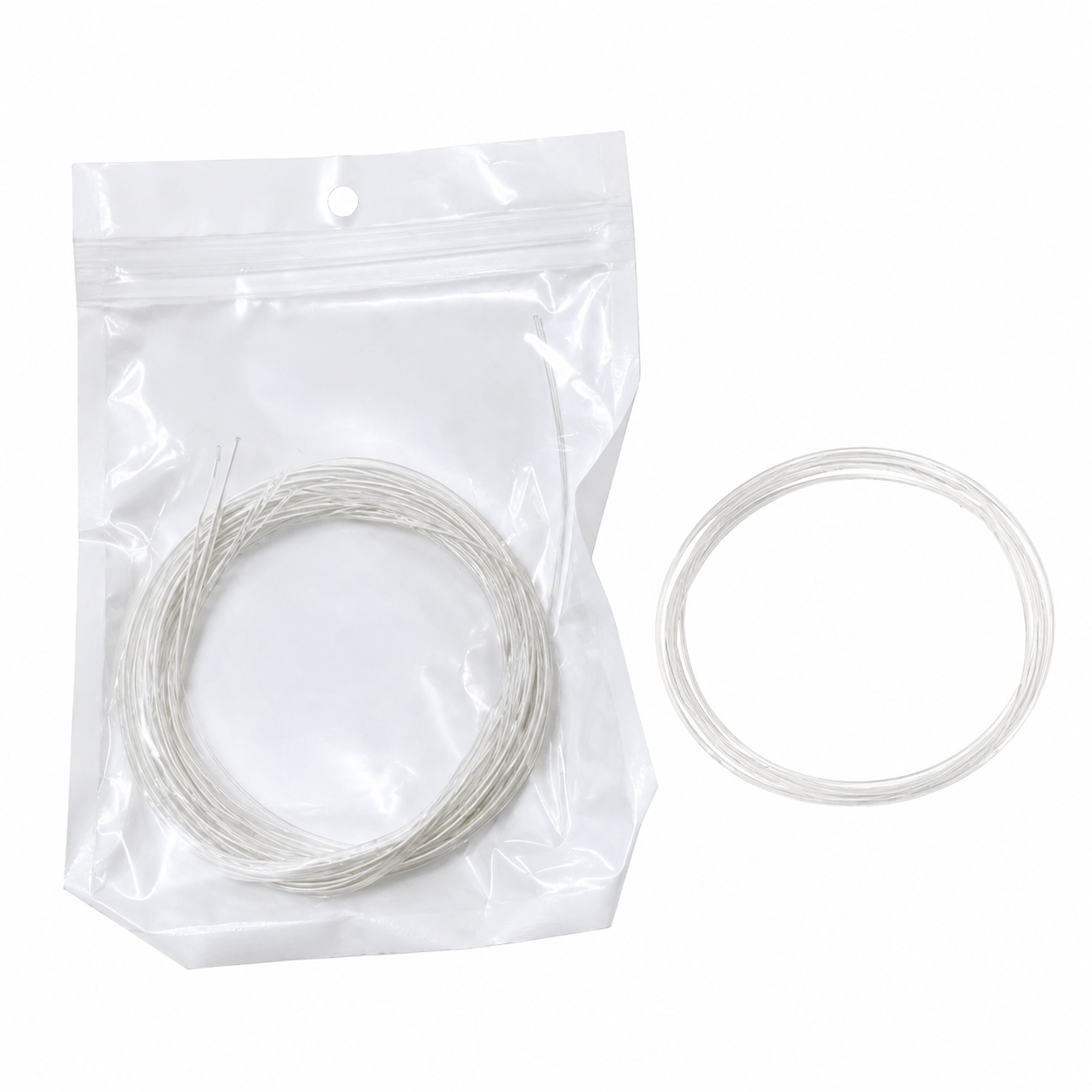

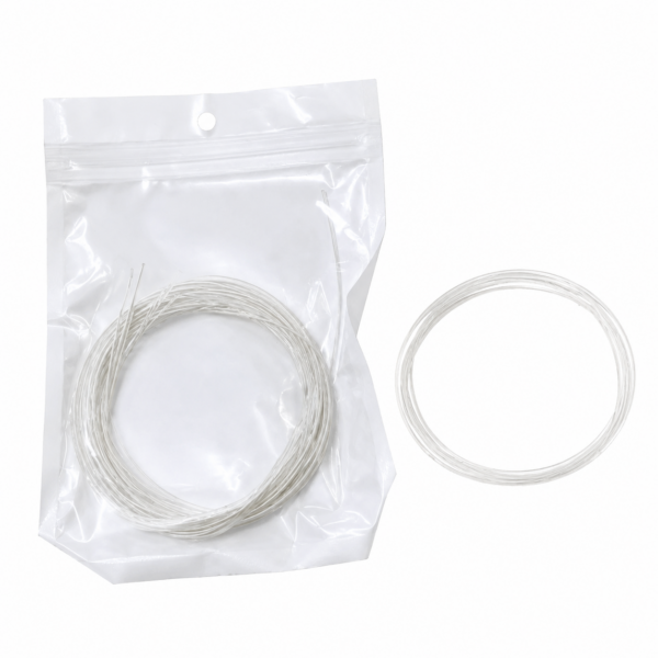

Replacement string set for any Carver Banjos kit. Save on shipping by adding to your purchase on the kit page at time of checkout. Shipping will only be charged when buying strings separately.
Category:
Set includes seven strings so you have a wide range of tuning options. These strings are simply classical nylon guitar strings with an extra string. You will receive a pack of six strings and one loose string.
Tuning explanation:
For open E tuning: this is the ideal tuning for these strings on Carver Banjos kits. E is three half-steps below standard G banjo tuning.
The single loose string (thin clear) is used as the 5th thumb string. In the pack of six strings, discard the two thickest silver wound strings. The thinnest silver wound string is used as banjo string 4. The thickest clear string is banjo string 3. The next thickest clear string is banjo string 2. The thinnest clear string is banjo string 1.
